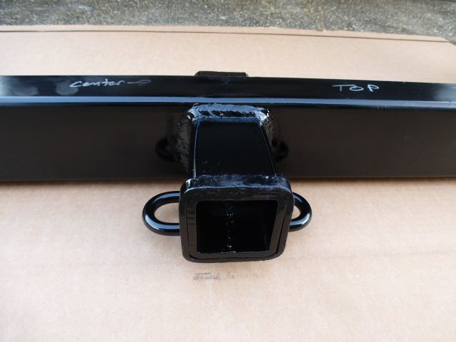

I just dropped my TH bumper and a 2" x 6" receiver off at the hitch fab shop. They said it would be $100 and ready Monday.

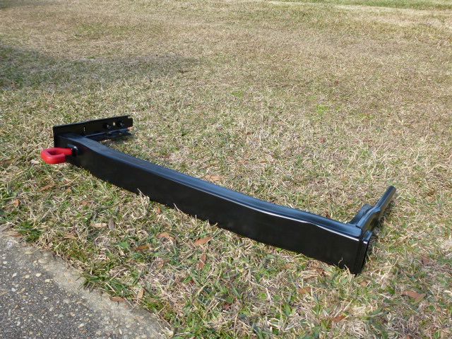

I just picked up my bumper with the 2" receiver installed by the fab shop. I could not be more pleased, and bonus was they only charged me $75. Can't wait to git-er-done!
They even painted it!
4,089 Posts
Looks good, especially for $75. You do the removal/reinstall yourself?

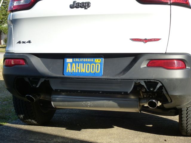

yes, I removed, will install tomorrow hopefully
depends on how much beer is consumed during tonight's BCS championship game.....

Looks great and a very good price. Good looking welds too. My only concern would be how much do you plan on towing and how much weight? The factory tow package gives you more then the hitch and wiring. Heavy duty engine cooling and a 3.517 final drive ratio. Brochure also says trailer sway damping but I haven't determined what that means yet.
2,757 Posts
The heavy duty engine cooling is part of the TH package anyway. The sway control is part of the esc system. The only thing missing is the lower gear ratio.

Gator- I'd sell my soul for you to hit me up with some details on how you did this. I've been fighting for weeks with the same issue you had. I NEED this...
I just took off the bumper, marked the center and top, took it to a trailer hitch shop, asked if they could cut a square hole in the bumper on both sides and weld in a 2" receiver, and showed them a few pics of a mopar hitch and a few pics I took at the dealership. They said no problem, an hours work.
No magic, just action.
The only thing I have different from the factory is the rear end ratio, which I am not to concerned about. I mostly use it for a bike rack or light trailer.
