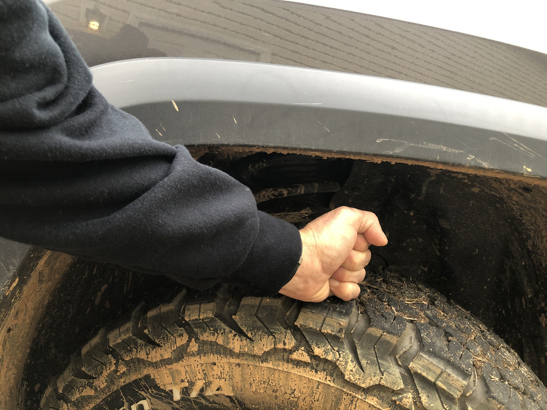

IDK, there doesn't seem to be any good lifts for the KL. I'd shell out more money if
Old Man Emu had a real 3" suspension lift, with new springs and struts.
Come to think of it, my son's TH has something going on up front. It was like
this when we bought it.

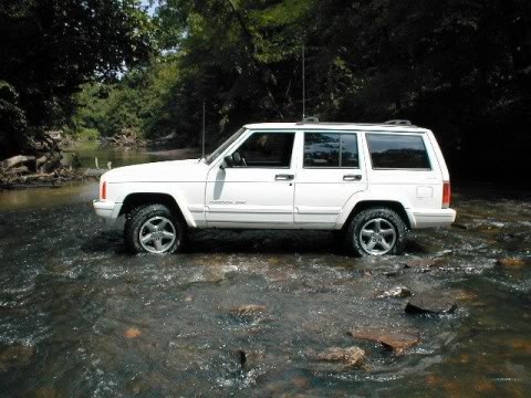

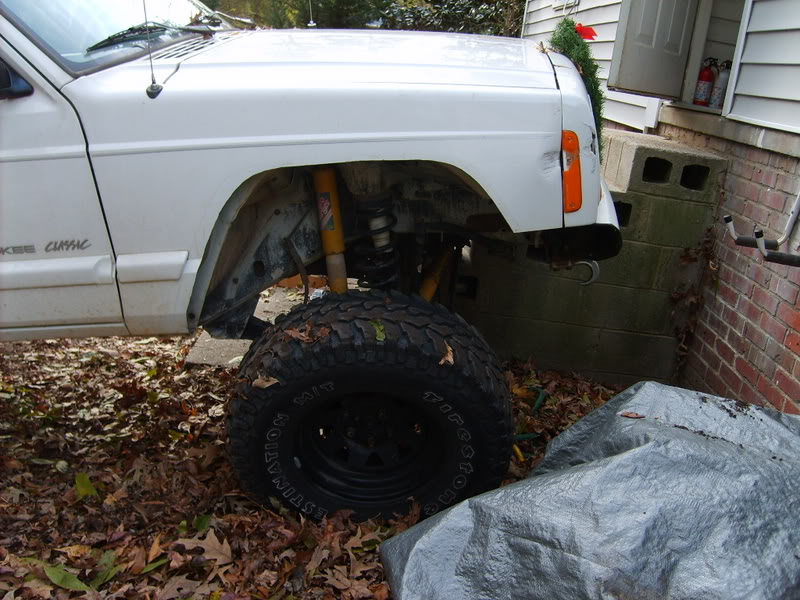

I really don't think 2" and a 1/2" bigger tire are going to net me the same results
when I installed my 3" OME kit, and my 31" FireStone Destination M/T tires...
Lift kit tires.
Other stuff, don't care anymore...
Wish I could figure out how to do a full suspension lift...
2" and a tad bigger tire won't help me much....
I got stuck 3 times screwing around. :ROFLMAO: 2" wouldn't have mad a difference.
