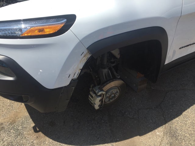

The process can be completed without removing your front tires but if you can I'd advise you to as it made the installation much smoother.

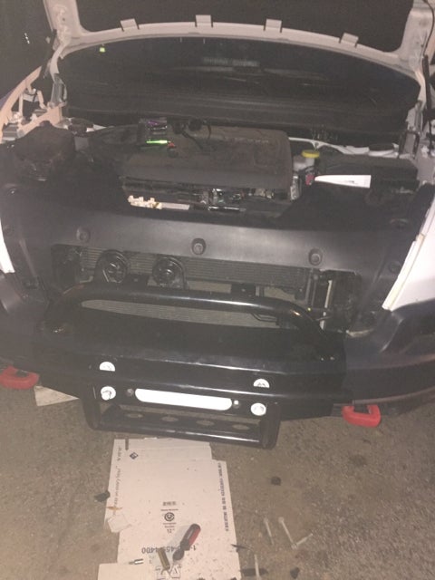

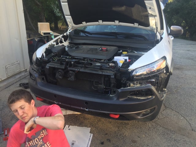

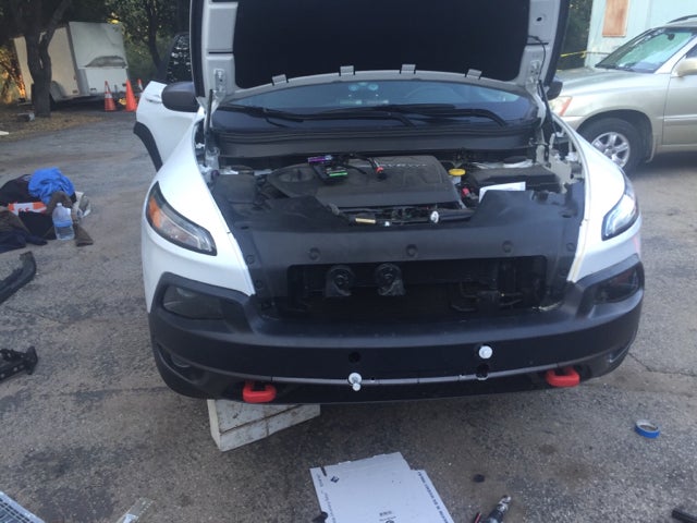

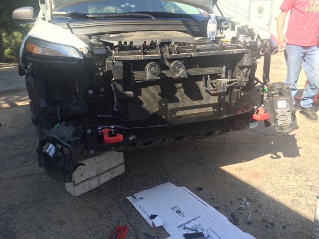

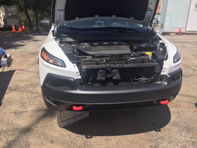

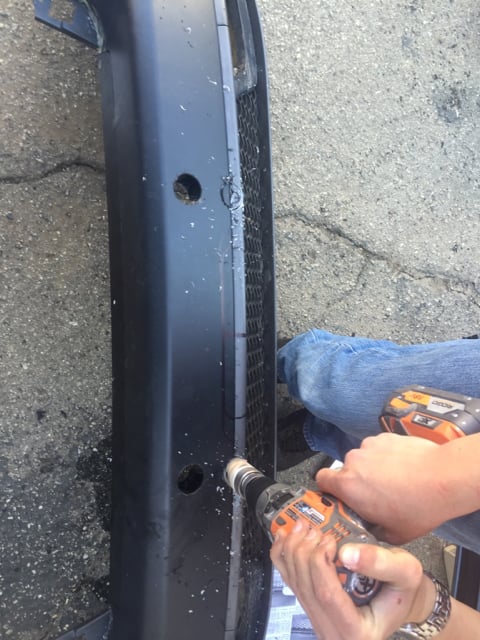

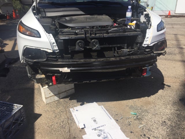

With the right amount of cussing and elbow grease I got the fascia and wheels off, bolted on the new winch mount, cut the required holes in the fascia, reattached everything I removed and bolted the new bumper on.
Through this entire process I never really encountered anything I couldn't solve other than a few hard to reach bolts until the very end. Of the 4 bolts attaching the bumper to the winch mount, only 2 of them are catching and the other two are making contact with the threads but not making a purchase. I'll probably put some time into figuring it out tonight.
See the photos bellow, I tried to document the process but I'm sure I missed a few steps along the way.
