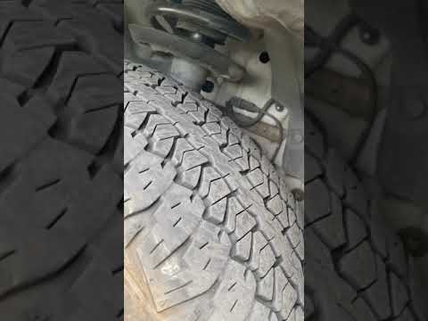

So, the TH has a weird issue that developed recently. When you turn the wheel, especially on any sort of slope, there is a clanking or knocking noise coming from somewhere in the front axle/power steering rack area. I will upload a video in a minute.

here’s the video
The car is in the on position in this video, not running. Just giving the wheel a little back and forth. It is on a downward slope:

Not sure if it’s an issue but I’ve never noticed my strut move nearly as much as yours just did. Maybe it normal but might be worth checking out.

Yeah, I was looking at that, however, there was no noise coming from there specifically.
update on the issue though. I crawled under the car last night extensively listening for any noises. It’s gone completely. Even driving around there is nothing. Now I’m thinking the dealer is trying to just make a ton on something they didn’t diagnose and don’t need to replace (probably primarily because of the warranty). The appeal to the claim still hasn’t come back but I don’t think I’m going to have any work done by this dealer, seems shady. I’m thinking of just having another dealer do an inspection and give it a good bill of health and just see if it ever comes back again. Still need to sort out the denial, because if they are going to play the pre-existing game, I don’t see how this warranty will ever cover anything…
